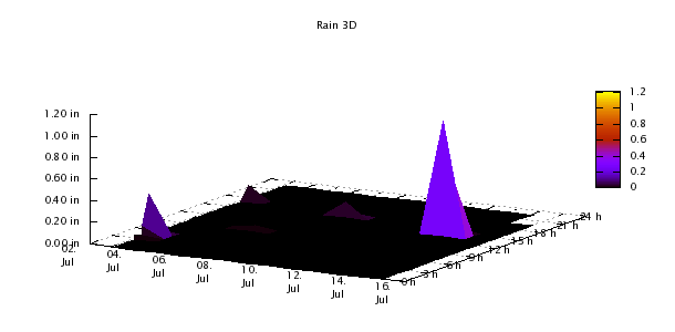

Hello -- I am trying to get a decent looking 3D graph for rainfall. I have attached my current attempt. Does anyone know how to get rid of the black that covers the grid?

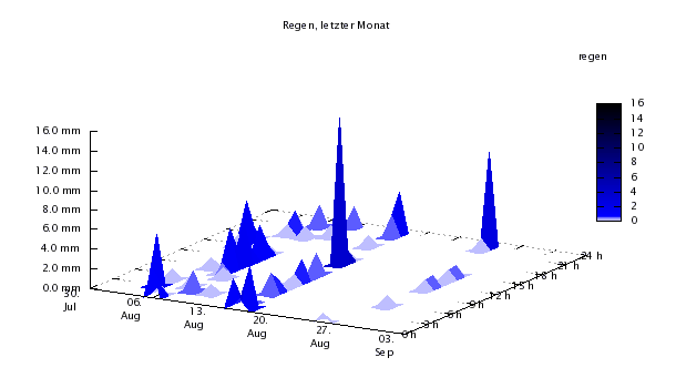

you need to modify the color code, because in your exmaple (the default color code) zero is black. When you do
set palette defined (0 "white", 1 "blue", 20 "black")
you get something like the one below. A bit more playing with it should give you the expcted result.
