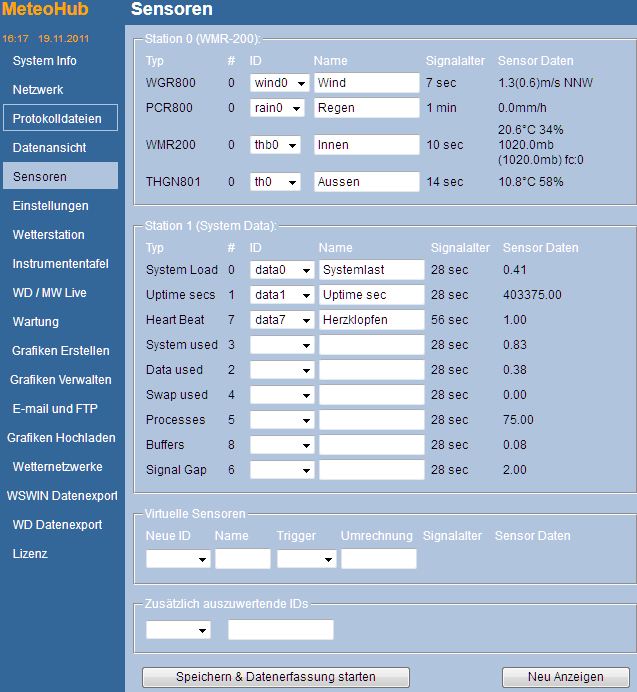

did you change the weather station during that period?
does "press" report correct values?
Did you choose "height plus th0 temperature" as sea-level calculation method?
could you please post your "sensors" page, to allow me to see how "th0" is mapped?

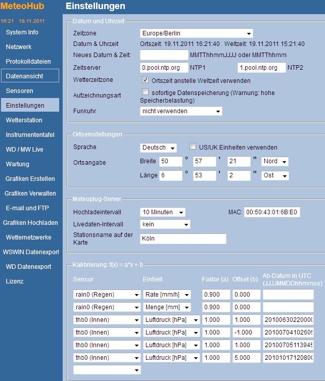

"Press" reports the same values because the baro correction is an offset in meteohub settings (since 2010-10).
I don't use an offset in the console.

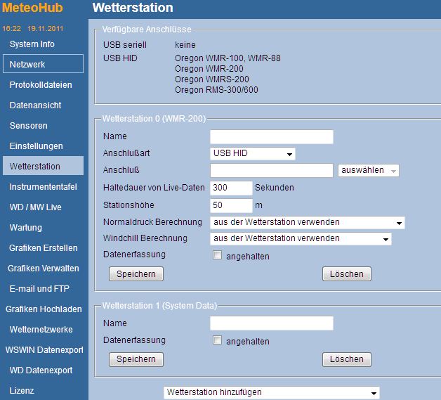

Sea-level calculation is "aus der Wetterstation verwenden".
The values of sealevel (year1 and alltime) are increasing very quickly now, they are now 1020.6 (from 1020.3 yesterday).
All values are here: http://koelnerwetter.de/meteohub/all-sensors.txt

Thanks for giving me login details.
Your station does send indoor temp and pressure data very often (10 times my station does), so that a lot of 1/10 hpa values (9600 to 10500) have to be summed up for average value computation. Looks like this results for longer periods (year, alltime) into a 4 byte integer overrun. I changed to 8 byte integers and results on your system seem to look ok now. Please check. If this fixes it, it will also be part of the next official update. As it only affects "aggregated" data a recomputation run, which is automatically initiated after the next update, will fix it for all users.
Thanks for finding out this hidden issue.
