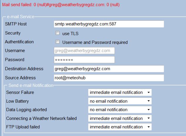

here is a clip from my meteo setup push services. why the error message?

regular smtp port is 25, try TLS and check credentials from your provider.
