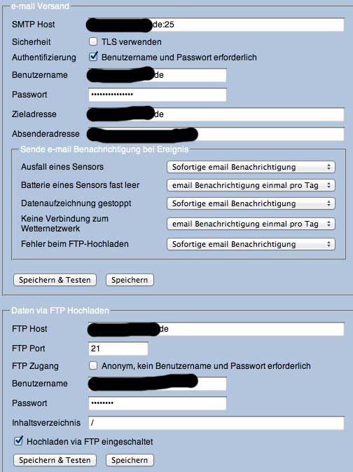

could you please provide a screen dump of your "psh services" meteohub page.
ZebraWetter
Posts: 22
Joined: Sun Aug 14, 2011 11:44 am
Location: Duisburg/northrhine-westfalia/germany/earth/sol system
Re: FTP upload does not work
Post by ZebraWetter »
Here it is ...
It set anonymous upload, saved, unset anonymous upload and saved again, just to rewrite the config, but it won't work.
push services
push services
cgn
Post by cgn »
"Benutzername" and "Zieladresse" seem to be the same in your settings (same length).
Usually "Benutzername" is "Vorname.Nachname" and "Zieladresse" is "Vorname.Nachname@Provider.de"
It's the same as the settings in your email-program.
"Absenderadresse" is "root@meteohub" (in my settings).

FTP does not work, eMail does! :wink:
Did you try to ftp from a pc with the exact same values? Only when i tried it with copy paste i found my typo- error.

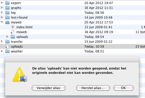

Exactly the same problem with my new DC01. Using 4.9f or g makes no difference. Saved my credentials first, hit save & test and got a white page.
So far the same.

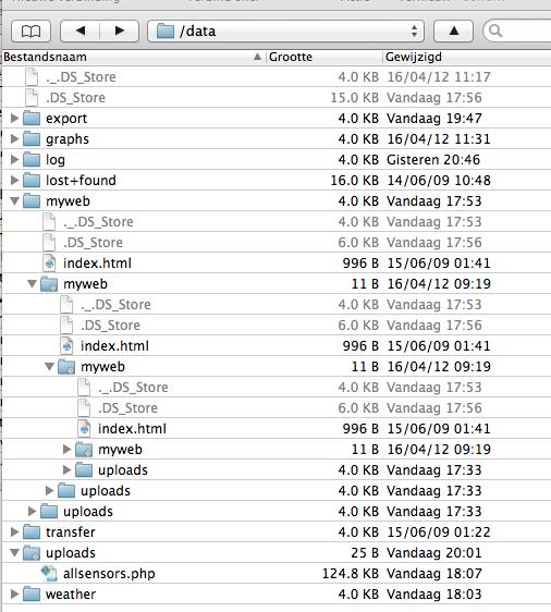

But looking in the /data/ folders:
The file to be uploaded (as set in "Graph Uploads") arrives in the /data/uploads/ folder
AND in the /data/myweb/uploads folder every so many minutes.
But than the whole /data/myweb/ is duplicated inside the my webs folder.
I made a screenshot to explain.
Do not know what is happening, but my big disk will be filled up very soon.
I deactivated ftp-upload (SPS page checkbox) and removed Graph uploads but still new myweb and upload folders are created. Now with only the lastto-be- uploaded file. Now the system reboots but there are so many myweb folders that it will take some time to see of the creation of new ones has stopped.
Still no solution by anybody for our FTP upload?
I switched weatherstation from listen to old meteohub poort 5500 to direct ip adres of ip-logger, reboot DC01. Still the same.
I made a new screencapture. You can see the uploads folder it is a shortcut not a real folder. When you click on the uploads folder in data one gets an error message that the folder does not exist (at least for a mac).

Posts: 8033
recursive myweb folder is a bug, which will be removed by the next update.
