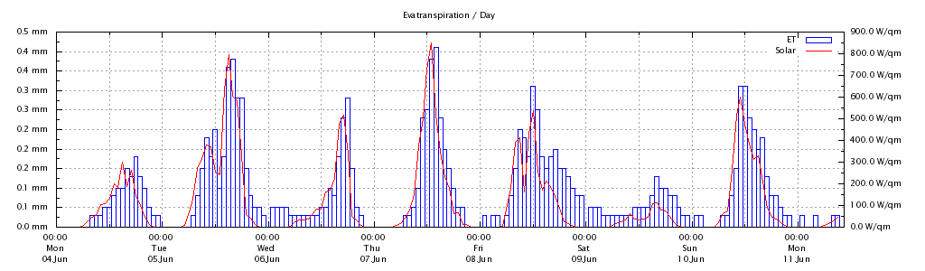

Hi, I can create graphs, this is my definition:
cat ET-7Days.mg
Evatranspiration / Day
format
language 0
tf_mode 1
last_num 7
last_ind 2
tr_ind 3
crop 0
xsize 1024
ysize 300
fontsize 7
dspmode 0
left_unit 10
right_unit 8
left_measure 0
left_measuremin
left_measuremax
right_measure 0
right_measuremin
right_measuremax
left_gmode 2
right_gmode 0
left_sensors 1
left_sensor-0 sol4-et (Davis-Solar)
left_sensorcolor-0 3342591
left_sensorname-0 ET
right_sensors 1
right_sensor-0 sol4 (Davis-Solar)
right_sensorcolor-0 16711680
right_sensorname-0 Solar
However.....
I'm not running 4.9j yet, I'm running 4.9i build 6671 (Alix) which was build on my system by Boris to test the ET changes.
So it might be that something went wrong during the final build.
YSbrand
