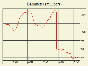

Can I get an update on the status of the CWOP bug. I'm having the same issue. I just got done analyzing my packet data and was ready to add an offset, when I found these posts. Thanks for any information.

I apologize. I didn't realize there were two different issues. I am asking about the issue related to incorrect pressure readings being received by CWOP. I noticed that I started receiving barometric pressure error messages after upgrading to 4.9p. I only started looking into it this weekend. I will review your work around details. Thank you for providing them. (My example of the issue is attached)
- My pressure data after upgrade
- Screen Shot 2012-09-30 at 3.08.51 PM.png (7.72 KiB) Viewed 24536 times

Yes, it appears you have the first issue with the wrong pressure being transmitted to CWOP.

I just found a bug in the code that sometimes prevents from getting the right sensor altitude. This is a bit more complicated as it sounds because Meteohub can feed many stations all with different altitudes.
Please give this update a try (www.meteohub.de/files/update-v4.9q.upd) by downloading, placing into the Meteohub PC network share "/public/transfer/". Then install via Meteohub webinterface "update (file)" by giving the path "/data/transfer/..."

2012-10-01 01:02:05 UTC: N5XL>APRS,TCPXX*,qAX,CWOP-2:@010102z3348.73N/11147.18W_225/003g009t092r000p000P000b10140h15eMH49
As console pressure has risen to 918.4 and 918.7 hpa in the time its taken me to gather the data, calculated altimeter should now be 1013.82 and 1014.15. Meteohub reports 1013.7 and 1014.0. This is seen in the raw packets and Altimeter is correctly expressed when using CWOP servers...nice.
The final check is to see if the data is making it to MesoWest. Correctly showing values in MesoWest means that all stages of this process are working as they should.
Time Mesowest Meteohub
17:32 1013.00 vs 1013.0
17:42 1013.21 vs 1013.2
17:52 1013.68 vs 1013.7
18:02 1013.99 vs 1014.0
This is exactly as it should be and confirms CWOP receives Altimeter properly...nice.
This emergency release of 4.9q build 1187 looks good to go as it corrects the barometric pressure issue and looks to have also addressed the CWOP server connection issue as well. Nice job.
