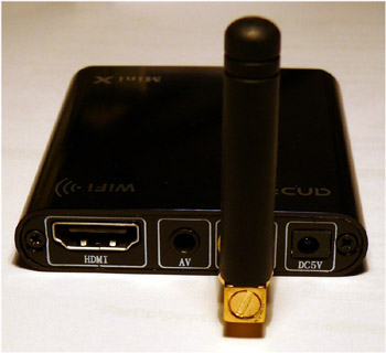

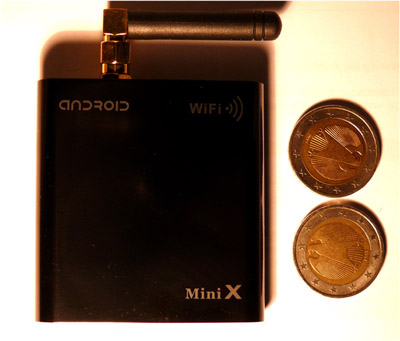

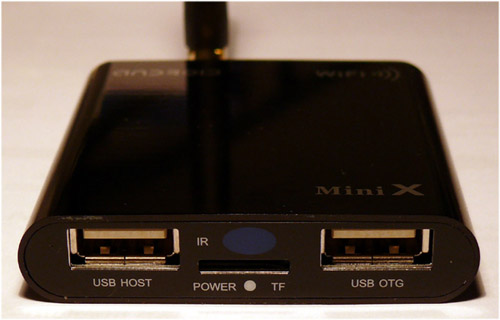

I am currently working on a port to the Mini X systems based on Allwinner A10 SOCs.
These are world wide available on ebay (search for "android minix").
From my perspective this makes a Meteohub port to the less capable Raspberry PI obsolet.
Main Features:
  • 1GHz clock speed (variable clocked)
  • 512 MB RAM
  • one USB port (USB OTG port is not supported by kernel I work with)
  • integrated WLAN
  • HDMI output for setting up system initially with a HDMI monitor and USB keyboard connected when entering WLAN credentials
  • just a few watts of power consumption
  • Meteohub resides on a 8GB microSD card (preferred an industrial one)
First beta port is available. If someone would like to test on his MiniX, please drop a note.
Form factor is really nice:

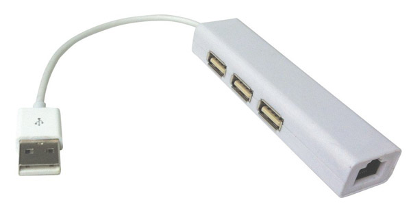

When you want to connect more than one USB device plus LAN, this might come handy (search ebay for "LAN Adapter 3 Port USB Hub"):

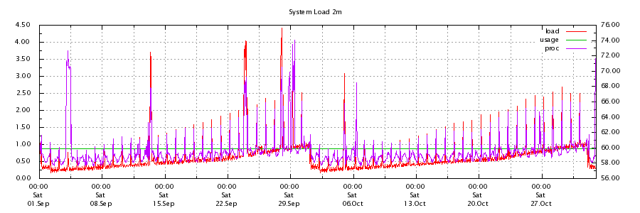

Wishlist for meteohub:
2 month load
2 month load
  • -No load rising during the month

a) load rising during the month is a no-brainer, what harm does that produce?
