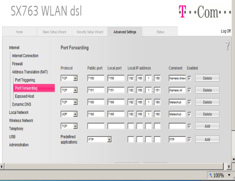

I changed router port 22 forwarding of both ports to Meteohub. Now I can see meteohub in WinSCP, but I lost access via browser.

For web access you need port 80 and for ssh you need port 22. If you change one value to another, the other one will stop work. So use both. Or better use ssh only when you need it (disable it when not needed).
