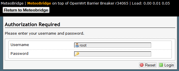

Meteobridge just shows OpenWrt login
When you see just the screen below and Meteobridge keeps fast blinking forever, that is an indication that it cannot connect to the Internet.
Most popular reason is that you changed something with your network settings in Meteobridge.
When you did change to static IP you might have not set the right mask, gateway and/or DNS IP.
Failing one of these will make your Meteobridge disfunctional.
How to recover.

When you still get the OpenWrt screen instead of the Metobridge login screen, then your browser's
cache is fooling you. Try restart the browser or press "Return to Meteobridge" zu get the correct
login screen, which pops up as a standard http login screen with user name and passwort of
your browser.
