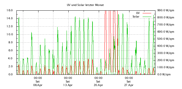

My VP2 recorded strange uv values on 3 days in april:
I went into the file raw of april and found a lot of "uv0 0160" during these days. I replaced these values into "uv0 0" and made a recalulation.
Unfortunately the diagram above didn't change. I checked the raw data again and the uv0 is 0 during these days now.
Do i have to change something else ?

Changing raw data is the way to go, or to delete invalid records with "inspect data" page.
After recomputation finishes, changes do apply to graphs.

I had to restart my Meteohub after the recalculation. Now the uv diagramm is ok without the wrong data.
