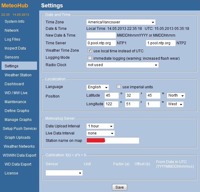

Meteohub is not processing station data since the 4.9u update. After a reboot, it reads the log from the station, then starts complaining that the system date is not properly set, so logging can't start. The system date on System Info is correct.
Any help is appreciated.
Ed
BTW, My previous config had the serial Vantage plugged directly into the SheevaPlug via a TrendNet TU-S9 Serial-to-USB adapter. I have since tried connecting with a small unpowered USB hub between the TrendNet and the SheevaPlug.
System Info / Time
UTC:	13.05.2013 02:54:10
Time Zone:	America/Vancouver
Local Time:	12.05.2013 19:54:10
Uptime:	18 hours, 40 minutes
System Load:	0.00, 0.03, 0.05

> Please do not select using "weather station RF clock" (I dont know how it is phrased exactly)
Do you mean "Radio Clock" ?
Mine is sent to "not used" See attached.
Ed
meteohub settings.jpg (113.46 KiB) Viewed 5398 times
