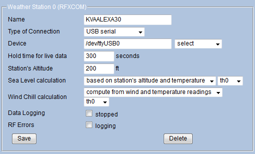

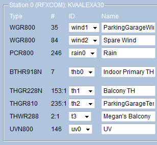

I could login and check. Reason for wind sensor data not being presented is that temp sensor
specified on "weather station" page to be used for windchill computation is defined as "th0"...
...but there is no "th0" sensor defined. When changed to "th1" wind sensor data does come up again.
It is not very obvious, but root cause was exactly that.
