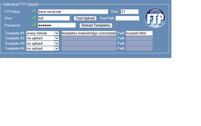

Now I'm working on Individual FTP Uploads and just can't get it to work.
I can get the "Test Upload" to work.
My "mydash.html" won't up date the info into my simpledash.html
Any help would be nice.

The template file (which Meteobridge uploads after having replaced the variables by sensor data) needs to be located somewhere in the Internet. Please tell me the URL, where Meteobridge is expected to load it from and where I can have a look at it.
Can you please provide a screen dump from meteobridge ftp upload settings.

Re: need some help with Push Services
- ftp.png (74.57 KiB) Viewed 8128 times
I see uploaded files there, so what exactly is your problem?
Is "mydash.html" not uloaded in the given intervals?
Does generating a test file with "Test Upload" button work?
No-one apart from yourself can get the upload credentials to your server right (including the correct destination path).

My FTP Upload looks like this:
FTP Host: http://www.excel.net Port 21
User: kaf
Password: *********
Template #1: (every minute) (templates.meteobridge.com/like-simpledash.html) Path (mydash.html)
Example above defines an upload schema to FTP server "ftp.myserver.com" for user "myself". Template templates.meteobridge.com/simpledash.html has been loaded on start up of Meteobridge and will be updated with recent data every minute and then uploaded to FTP server as file "mydash.html". When you view "mydash.html" with your browser it looks like
User: kaf
Password: *********
