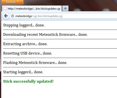

Firmware of Meteostick can be easily updated with standard Arduino tools. The Meteostick behaves like an Arduino Uno (ATMega 328) and has to be connected via its virtual COM port, configured to 8N1 and 115200 baud. Updating firmware depends a bit of the hardware you use.
When you have a Meteobridge, just plugin the Meteostick and browse to http://ip-of-your-meteobridge/cgi-bin/stickupdate.cgi (please don't type this literally, but insert the LAN IP of your Meteobridge), wait a few seconds. When a success message appears, you are done.

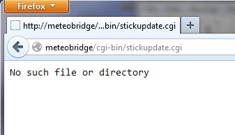

If I try to update my Meteostick on my Meteobridge Version 2.2 (Build 2457) I got an error message.
Is there somewhere a way to read the current Firmware Version of the Stick?
Klaus
Re: How to update firmware of Meteostick
Which HW platform? MR3020, WL330N3G?

HW Plattform: Asus WL-330N3G

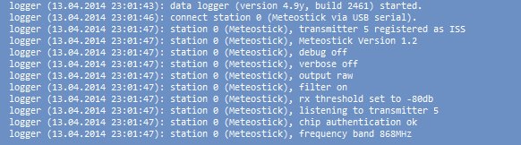

After new Meteobridge Update to Version 2.2 Build 2461 the Meteostick update with the stickupdate.cgi is no problem.
After the stick update the logger process shows the stick version in his messages.

I forgot to make corresponding changes to platform WL-330N3G public, is done now. All WL-330N3G will now
be able to update connected Meteosticks after a reboot.
