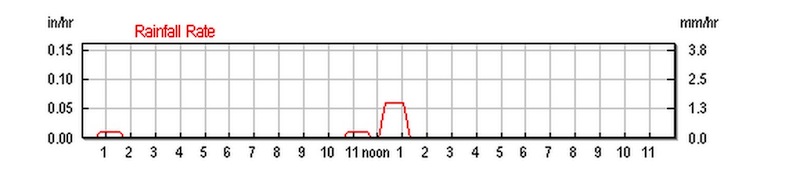

One thing I noticed about meteobridge uploads to weather underground is that whenever it rains, even if it is just 0.2mm the rainfall rate will stay at 0.2mm for the whole hour before returning to 0. This is misleading as if it is just a 5 minute shower and it is showing as if it is raining for an hour.
In addition to this, The rainfall rate is never a true reading. For example if it rain 5mm in 30 minutes, the reading will be 5mm/hr up to that point.
An example of this would be today as I had 2 short heavy showers, one recorded 2.0mm and the other 1.3mm. Now on the graph it shows a rain rate of 2.0mm/hr for the first one and 1.3mm/hr for the second one, whereas realistically, it was around 8mm/hr for a while:
What I would like to see would be smoother rainfall rates such as this, from another nearby station: They reflect more realistically of the intensity and length of the rain.
I don't think this is impossible as meteobridge does actually show the maximum rainfall rates in the live data feed, and would love for these to be then reflected onto weather underground. Or at least change the 1 hour rainfall rate problem.

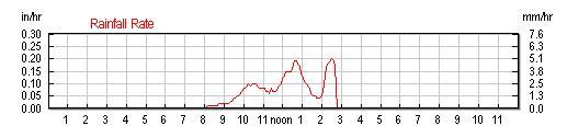

I'm not noticing the issue you are showing, and I am using a Davis Vantage Pro2 with Meteobridge. My rainfall rate grph (for the last day it rained) is as shown:
The rainfall rate, as you see on my graph, is showing correctly (for me): the rate (at that particular time) of precipitation per hour.
You could have .25" of rain fall in a 15 minute period, and that it -- in which case your rainfall RATE was 1"/hour for that 15 minute period.
