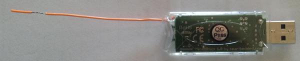

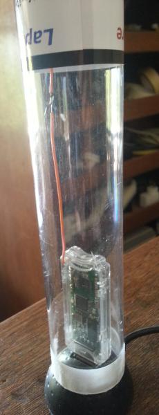

my cat has bitten off the antenna of the meteostick ( 1 cm ). Now I had to protect the Stick with a plastic or paper tube :wink:
I recieve the datas without any problem.

Good length is 8 cm. Any wire will do.

admin wrote:Good length is 8 cm.
It is a good idea to solder the missing part?
Best Regards
Joachim
http://www.puttkammer.de
Re: [OT] antenna - chat
You have 3 options:
- soldner the missing wire length to the top of the remaining wire
- Open enclosure (snapped in only) and solder new antenna wire
- send stick to me (mit frankiertem Rückumschlag) and I replace wire
You can also let it as is, but rf reception will be weaker than before. At least this is what theory tells me.

admin wrote: - soldner the missing wire length to the top of the remaining wire
I have choosen this option.
und so ist Stick und Antenne nun geschützt
