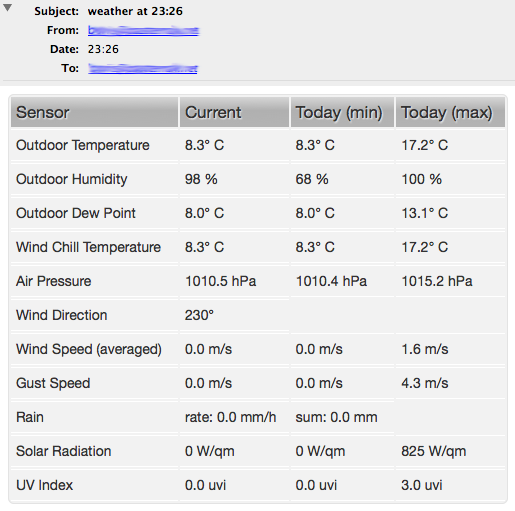

Re: Subject Line for Push Emails
To get a nicer e-mail I want to include some html style settings.
There is a very nice template (as used for the ftp example) I try to use in an e-mail.
http://tau.meteobridge.com/templates/simpledash.html
That does not work as the message:
Meteobridge settings successfully reloaded
Warning (Event #01): Removed bad character in email body: "
Even with a one line message, the quote is removed in all occurences.
I found no way to have an " " " character correctly (translated) in the message part of the email .
But using class= or style = needs that double quote character.
Does anyone already found a solution?
Double quotes are not supported, try single quotes.
To prove that HTML mail is working fine I took the "simpledash.html" file from
"http://templates.meteobridge.com/simpledash.html", removed all linefeeds,
tabs and repeating blanks from it and replaced the double quotes (") by single
quotes('). In addition I put a subject header in front, so that the body input field
for sending a formatted HTML mail looks like this (it needs Meteobridge application
stack from August 25, 2014 or later running):
weather at [hh]:[mm]\nContent-Type: text/html#<html> <style type='text/css'> #table-2 { border: 1px solid #e3e3e3; background-color: #f2f2f2; width: 500px; border-radius: 6px; -webkit-border-radius: 6px; -moz-border-radius: 6px; } #table-2 td, #table-2 th { padding: 5px; color: #333; } #table-2 thead { font-family: 'Lucida Sans Unicode', 'Lucida Grande', sans-serif; padding: .2em 0 .2em .5em; text-align: left; color: #4B4B4B; background-color: #C8C8C8; background-image: -webkit-gradient(linear, left top, left bottom, from(#f2f2f2), to(#e3e3e3), color-stop(.6,#B3B3B3)); background-image: -moz-linear-gradient(top, #D6D6D6, #B0B0B0, #B3B3B3 90%); border-bottom: solid 1px #999; } #table-2 th { font-family: 'Helvetica Neue', Helvetica, Arial, sans-serif; font-size: 17px; line-height: 20px; font-style: normal; font-weight: normal; text-align: left; text-shadow: white 1px 1px 1px; } #table-2 td { line-height: 20px; font-family: 'Helvetica Neue', Helvetica, Arial, sans-serif; font-size: 14px; border-bottom: 1px solid #fff; border-top: 1px solid #fff; } #table-2 td:hover { background-color: #fff; } </style> <body> <table id='table-2'> <thead><tr><th>Sensor</th> <th>Current</th> <th>Today (min)</th> <th>Today (max)</th></tr></thead> <tbody> <tr><td>Outdoor Temperature</td> <td>[th0temp-act.1:--]&deg; C</td> <td>[th0temp-dmin.1:--]&deg; C</td> <td>[th0temp-dmax.1:--]&deg; C</td></tr> <tr><td>Outdoor Humidity</td> <td>[th0hum-act.0:--] %</td> <td>[th0hum-dmin.0:--] %</td> <td>[th0hum-dmax.0:--] %</td></tr> <tr><td>Outdoor Dew Point</td> <td>[th0dew-act.1:--]&deg; C</td> <td>[th0dew-dmin.1:--]&deg; C</td> <td>[th0dew-dmax.1:--]&deg; C</td></tr> <tr><td>Wind Chill Temperature</td> <td>[wind0chill-act.1:--]&deg; C</td> <td>[wind0chill-dmin.1:--]&deg; C</td> <td>[wind0chill-dmax.1:--]&deg; C</td></tr> <tr><td>Air Pressure</td> <td>[thb0seapress-act.1:--] hPa</td> <td>[thb0seapress-dmin.1:--] hPa</td> <td>[thb0seapress-dmax.1:--] hPa</td></tr> <tr><td>Wind Direction</td> <td>[wind0dir-act.0:--]&deg;</td> <td></td><td></td></tr> <tr><td>Wind Speed (averaged)</td> <td>[wind0avgwind-act.1:--] m/s</td> <td>[wind0avgwind-dmin.1:--] m/s</td> <td>[wind0avgwind-dmax.1:--] m/s</td></tr> <tr><td>Gust Speed</td> <td>[wind0wind-max5.1:--] m/s</td> <td>[wind0wind-dmin.1:--] m/s</td> <td>[wind0wind-dmax.1:--] m/s</td></tr> <tr><td>Rain</td> <td>rate: [rain0rate-act.1:--] mm/h</td> <td>sum: [rain0total-sumday.1:--] mm</td> <td></td></tr> <tr><td>Solar Radiation</td> <td>[sol0rad-act.0:--] W/qm</td> <td>[sol0rad-dmin.0:--] W/qm</td> <td>[sol0rad-dmax.0:--] W/qm</td></tr> <tr><td>UV Index</td> <td>[uv0index-act.1:--] uvi</td> <td>[uv0index-dmin.1:--] uvi</td> <td>[uv0index-dmax.1:--] uvi</td></tr> </tbody> </table> </body> <html>
When the mail reaches my inbox it looks like this:
