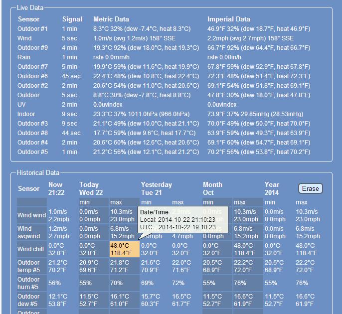

I have a wrong data of 48.0°C / 118.4°F wind chill. This is an error.
Can be fixed?
You can see the image.
Wind Chill.jpg (90.96 KiB) Viewed 5741 times

yes, you can edit the fields by clicking onto them. The wiki gives details:
http://meteobridge.com/wiki/index.php/L ... rical_Data
Start editing the values for Today, then Month, then Year.

Thanks I can change the data. But meteobridge wrong again and now writes 47 ° C. There is an error in the formula?

Re: Wrong Wind Chill
What type of station do you have? Must be something special with your setup.
Did we apply some sensor ID remapping regarding your primary temp outdoor sensor?

Oregon scientific wmr 200

admin wrote:What type of station do you have? Must be something special with your setup.
Oregon scientific WMR200 with standard configuration. He wants my MAC address to check my configuration?

I have the same problem wihh the same weather-station (WMR200).Thanks.

ok, could you please grant me access as explained here and send the link to "info(at)smartbedded.com" including the password?
viewtopic.php?f=57&t=9885

admin wrote:ok, could you please grant me access as explained here and send the link to "info(at)smartbedded.com" including the password?
Version 2.4
released October 23, 2014
fixes bug in windchill computation for wmr200
