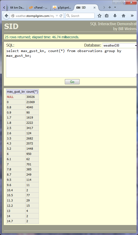

I noticed when I used the field in my database that is fed with [wind0wind-max2=kn.1] from the meteobridge I seem to be getting results grouped in certain values without "in between" values that I'd expect;
For example it seems unlikely I'd have 2222 results of 1.8kn and 3417 results of 2.5kn without anything in between?

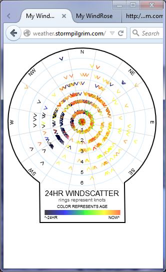

I first noticed it when making the below chart when it had data only at certain ringed intervals;

Vantage delivers wind speed in mp/h without decimals. Therefore you have these steps.
