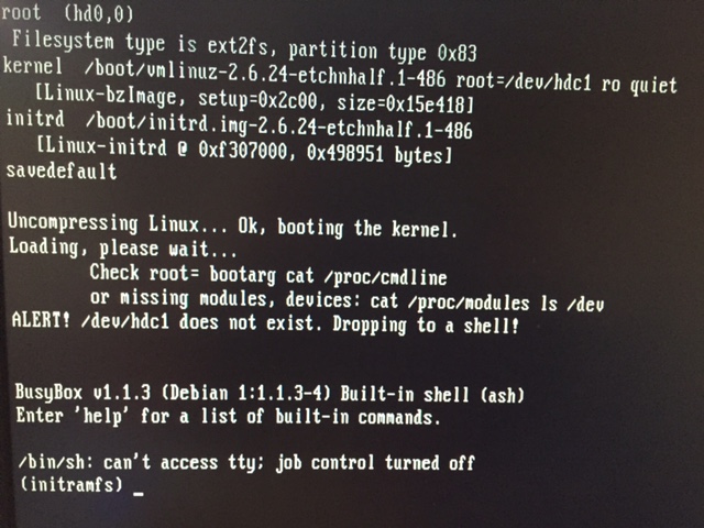

I have copy the boot USB to the cf Card without problem "the sytem said remove USB.."
But now when I start Meteohub I have this message :
what the problem ?
thank you

I can't remember the wiki saying that you should copy USB stick image onto CF card.

I don't understand your answer...
I made this 5 steps without problem :
Installation from USB Stick
Connect monitor and USB keyboard to your ALIX.1D
1. Boot into BIOS by pressing "Del" key during startup. Once in BIOS select "Advanced BIOS Features" tab and choose "Removable" as "First Boot Device". Select "Hard Disk" as "Second Boot Device". Press "F10" to store this configuration and restart.
2. plugin USB stick to boot from
3. System boots a Debian Linux from USB stick and starts Meteohub setup procedure for CF card. Data already stored on the media will be erased without further warning!
4. Installation process halts with asking you to remove USB stick and to restart the system once again. Please press "Del" key during boot to enter BIOS setup mode.
5. Select "Advanced BIOS Features" tab and choose "Hard Disk" as "First Boot Device". Press "F10" to store this configuration and to restart.

? Could you help me I have not find a solution....
