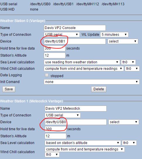

I have two USB devices connected to my Rapsberry PI
USB0 - Davis VP2 Console
USB1 - Meteostick.
After switching the Davis VP2 Console to USB1 and the Meteostick to USB0 the firmware works.
USB1 - Meteostick.
