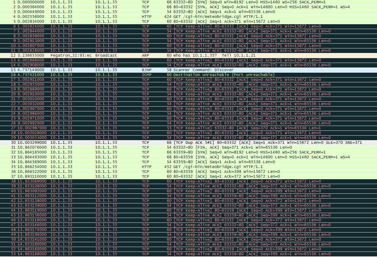

I don't know much about IP and networking at this level, but when I capture packets which reference the MR3020 (in wireshark), after I attempt to access meteobridge all I get is lots of [Keep-Alive]/[Keep-Alive ACK] pairs in rapid sequence (aside from the initial TCP and HTML.
This is [Keep-Alive] from the mr3020 (10.1.1.35) , [Keep-Alive ACK] from my PC (10.1.1.33).
Line 1 is whene I entered 10.1.1.35, line 30 is when I clicked on the link on the black screen.
Any clues here?
