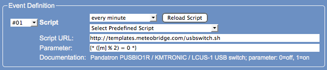

Beside a bug in the usbswitch script it turned out that testing a USB relay can be a bit cumbersome.
Therefore, you might find this definition helpful, which toggles the relay each minute.
Screen Shot 2015-11-03 at 19.52.11.png (28.82 KiB) Viewed 2287 times
This is how it works:
  • * the script is executed every minute
    * script parameter is the result of a numerical computation, which is indicated by {* and *} brackets
    * [m] reports the current minute, % 2 takes the minute modulus 2 which means that every even minute the result is 0, on odd minutes the result is 1
    * the comparison = 0 returns 1 when true or 0 when false
    * usbswitch script is called with parameters 0 and 1 changing each minute
Yes, you can also omit the comparison and say {* [m] % 2 *} but I wanted to show the comparison as it might be helpful on other occasions.
