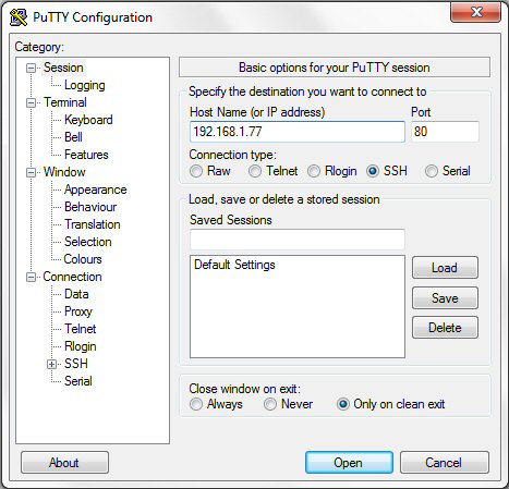

Hi!
I have the same problem.
I try to connect with putty, but it wont work.
Am I doing right?
Am I doing right?
- putty.jpg (52.46 KiB) Viewed 6941 times
Re: Losing GUI interface on RPI 2
putty and port 80 is not a good idea
Did you use SSH before or is it the very first time?
Standard SSH port is 22.

I just bought the RPi and just installed meteohub with my rfxtrx433e. I am tired of having my laptop on 24/7 with my weatherstation.
I have not use SSH before.
