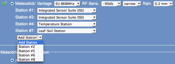

We have beta code running that allows Meteobridge with Meteostick and MB PRO (red) to receive RF data from a free selection of up to eight Davis sensors. Like envoy8x it can be any mixup, multiple ISS, etc.
Selection is done in this way:

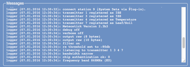

Message window shows data logger being started with these parameters:

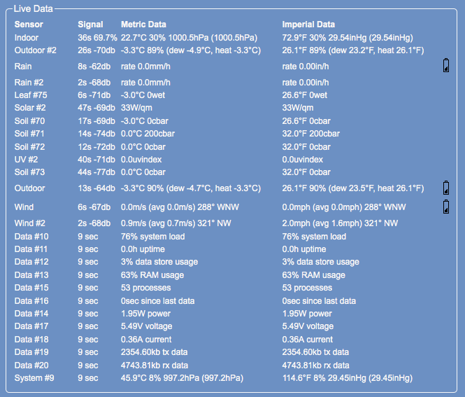

This is how live data is looking like (MB PRO also has system data attached):

Rules of enumeration and visibility of sensors are as follows:
1) first transmitter with an ISS is mapped to the primary sensors (th0, thb0, wind0, rain0, uv0, sol0)
2) all other sensors are mapped according to their transmitter ID
3) when a wind station is defined, its wind sensor is taken as primary sensor (mapped to wind0) as it is assumed that this specialized station should report primary data
4) same for rain station (mapped to rain0) and for leaf/soil station (mapped to th10, th11, th12, th13, th14, th15, th16, th17, th18)
5) temp, temp/hum, soil/leaf stations are not reporting rain, wind, uv, solar data. If combinations are needed, define station as ISS. In that case all sensors are evaluated.
This should make standard installs correctly mapped with primary sensors from scratch and also gives the pro user room to evaluate larger sensor arrays.
While MB PRO does make all data persistent, on a standard Meteobridge selectors on time ranges like (max60, min2h) will only work for primary sensors. Reason is that standard Meteobridge does not have enough RAM/Storage to keep data sequences for on demand analyzes reaching into the past for more than a few sensors. Saying that, going with a MB PRO makes much sense when more than a primary sensor set is used.
