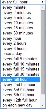

MeteoBridge has different schedules for every hours (Every Hour or Every full hour)
MeteoHub has one type defined for the hours, How I configure a upload task that runs every full hour (10:00, 11:00 12:00 hours) instead of every hour based on the time of configuration.
