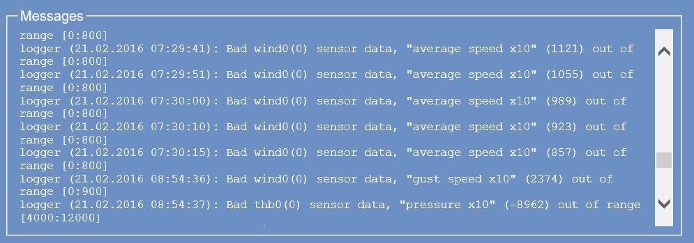

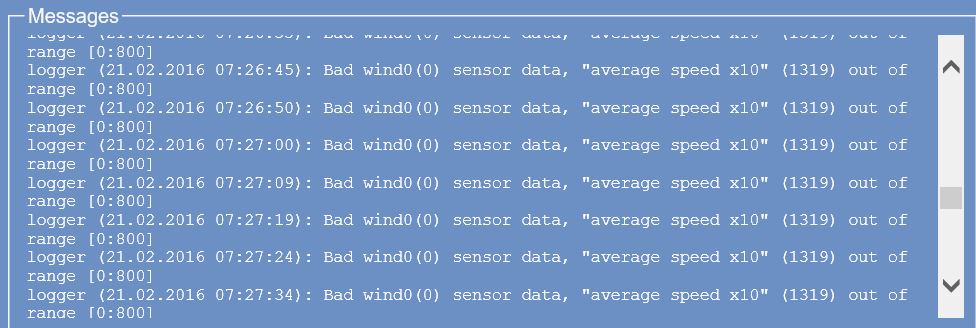

Hi, I am a brand new user of Meteobridge. Completed setup, everything seems to be working fine.
I always see good data both on the Meteobridge itself, and on Weather Underground. I understand that
the following blips are maybe to small to see online, and I just don't have good enough timing to see
it on the bridge itself. Since getting the bridge up and running for almost 24 hours I am seeing out of range
errors. Looks like "pressure X10 out of range", "Gust speed X10 out of range". Earlier in the list I also seen
"Average speed X10 out of range". Did not do an actual count on the number of errors that have been repeating
but it looks like in about an 8 hour time frame, these errors repeated probably a couple hundred times. Screen
shots below.

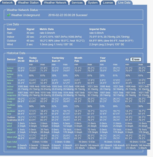

Understood. My weather station is an Acurite 1036. And will attach a screenshot of the Live Sensors.
Hope this is what you needed..

Re: Meteobridge error messages
Never tested on a 1036, just have had a 1035. While the 1035 could hardly report indoor humidity correctly,
that seems to work with your 1036. Negative rainfall makes me wonder. But may be the is just an
initial glitch with this station, so please delete rainfall values on historical section of "live data" tab
and check if this shows up again. Looks like wind also gets reported a bit different, but sorry to say there
is not much I can do, as Acurite is not even be sold outside the US (afaik) and I am reluctant to
grey import one from the US.
If you can convince Acurite to send me information on the data structures they use for USB coms,
I can give it a try. Without I cannot develop that remotely. Unfortunately, Acurite has never been
supportive in the past.

Not sure about some of the things you have posted. Rain fall amounts shown are correct, the rain fall RATES may be out of wack which I can delete, and did delete some
but not all. The accumulated rates reported were measured a week or so before I purchased the Meteobridge, but are correct. I am also good with the wind reported, min which would be zero, and the max for that particular day looks right.
I am just concerned about the error messages I have been seeing on the Meteobridge. Again I cannot see any issues with the numbers being reported to WU. These errors may only happen with 1 out of 9 samples not sure.
Also I could be wrong but I thought the only difference between the 1035 and 1036 was only one was color and one was not.

sfabre1963 wrote:Not sure about some of the things you have posted. Rain fall amounts shown are correct, the rain fall RATES may be out of wack which I can delete, and did delete some
My fault, rain rate raised my concern, not rain total. Wind stored here looks fine, but values blocked and listed in the messages section are rather strange. Looks like there is sometimes data coming in that is not structured as expected.
sfabre1963 wrote:I am just concerned about the error messages I have been seeing on the Meteobridge. Again I cannot see any issues with the numbers being reported to WU. These errors may only happen with 1 out of 9 samples not sure.
I can switch off the messages to give you a better sleep, but I think it is worth knowing that data seen has some challenges in it. :D
sfabre1963 wrote:Also I could be wrong but I thought the only difference between the 1035 and 1036 was only one was color and one was not.

As said, the messages indicate that unexpected data comes in. I also explained that I can't analyze in depth why that happens. Your station is not exactly on the list of supported stations and we both don't know what makes it different from the model I tested with in the past. So what do you expect me to answer?
