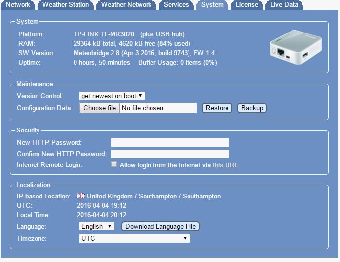

Automatic? (get newest on boot) Is one option. Click the "Version Control" option on System tab and select what you want it to do re updates

thanks for the reply. I will try, but the highest version in the pull down list is 2.7.
The main problem I've always had is every time there is a update available the meteobridge reboots and
the WPS/RESET led starts rapid flashing for ever ( the normal update time is a round about 3-4 minutes).

Re: Question regarding Meteobridge updating.
TinMan wrote:thanks for the reply. I will try, but the highest version in the pull down list is 2.7.
2.8 is the current version which still is not finalized and therefor not in the archive
