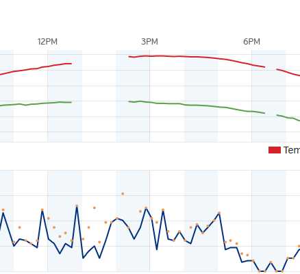

After a year and a half of pretty good operation I started having gaps in the wind data. After a full system and sensor reboot and new batteries (to make sure) the problem went away but came back a couple of days later with gaps in the temp/hyd sensor data.
There does seem to be data at the console, so I'm puzzled. Has anyone else seen this happen?
...now the temp data has gaps...

I visited on site for a while yesterday, and I can always see a temperature figure on the console (and in the MB "Live Data"), but none gets uploaded, sometimes for hours at a time??

It is curious to see clearly missing data for one sensor in the WU tabular view, even when the Live Data is fine.
