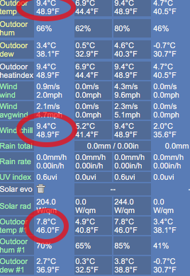

I have changed my primary temperature sensor into th1temp because this sensor is mounted in a better position (150cm) on ground level in the garden. Reading the windchill value's I have noticed that this value is still calculated with th0temp sensor, providing higher results than the actual temperature.
Does someone know how to change the primary calculation for wind0chill ?
Windchill Reading
Windchill Reading

I am using a Davis VP2 Pro UV/Solar and have attached a second Temp/Hum station. I am using the Temp/Hum station as primary because this unit is mounted at 1.5mtr level.
so th1temp is primary and and I am using wind0wind from the ISS sensors

Hi, I am not using the Davis VP2 Pro console. I am using the Meteobridge Pro RF, therefore readings go directly into Metobridge.
It is not possible to change the console primary sensors. I am using the Meteobridge as primary because the PRO RF has the benefit that the device can read the extra Temp/Hum sensors at a 0.1 degrees accuracy which the VP2 console only can for the ISS sensors.
I would think that the meteobridge will take the primary sensor to calculate the windchill based on the wind0wind readings because it is possible to set th0temp, th1temp etc as primary.
I am just thinking out loud :) My ISS station is fitted on a rooftop (13mtrs) and my second Temp/Hum station is in the garden at (150cm, the appropriate hight) and I have set the second temp to primary because it gives more accurate conditions.
regards, Eric

Newest update will apply the selected primary sensor to all windchill calculations.
