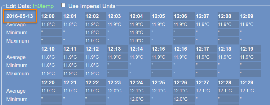

Hi
i trying to get data from 2 days back from today. if I'm right this should be the right thing:
[th0temp-min@D2] (min temp. 2 days in the past from today)
[th0temp-max@D2] (max temp. 2 days in the past from today.)
But thats not working for me?? :shock:
If I inspect the data in the history tab from MB-Pro I can see datas from that day (13.05.2016), so everything should be fine!
Any Idea?
Thank you!

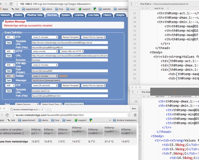

This makes my crazy !
really don't know WTF i'm doing wrong with those variables??? another example (attached):
many thanks in advance for any help!

Hello Marco,
Could you attach the file you use for MB-pro with the variables in it?
I will test it at my MB-Pro just to see if there is a difference.
And having the file, one can inspect the exact typing of the variables .
Without that it is fairly difficult to give an answer.

Re: HTML template with [th0temp-min@D2]
marco wrote:Hi Wim
yes of course, its just a snippet from the standard dashboard.html from MB-PRO. for testing variables!
Thank you !
Marco
I ran the same file on Meteobridge 2.8 (May 14 2016, build 9888), FW 1.4
Stored your text "input" file in the MB-pro templates folder as dash2.txt => and let MB-pro upload it as test.html
Uploaded file: http://leuven.meteobridge.com/leuven28/ ... /test.html
See attached screenshot.

wvdkuil wrote: I ran the same file on Meteobridge 2.8 (May 14 2016, build 9888), FW 1.4
Hi Wim
Thank you so much for your clean test. And for providing me your setup (build Nr. etc.) thats great!
My system was runnning the follwing setup:
Meteobridge 2.8 (Apr 28 2016, build 9814), FW 1.4
after the reboot:
Meteobridge 2.8 (May 16 2016, build 9899), FW 1.4
And now it works prefect!
it was (as allways) my fault, I had never thought to check the SW version without you!
again, thank you. marco
