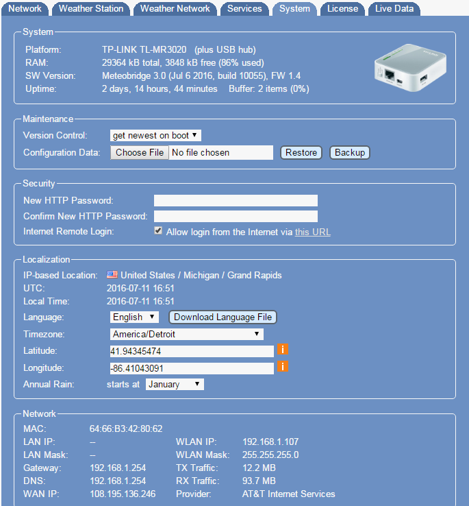

I can't say when it started but my system has started showing the following errors, that I would think are not normal behavior. Attached image shows system details (versions, etc.)
wnetd (09.07.2016 02:09:21): process started.
logger (09.07.2016 02:09:21): Historical data loaded (23 records).
logger (09.07.2016 02:09:21): data logger (version 5.0q, build 10055) started.
logger (09.07.2016 02:09:22): connect station 0 (WH-1080/3080 via USB HID).
logger (09.07.2016 09:22:24): Bad wind0(0) sensor data, "gust speed x10" (3967) out of range [0:900]
logger (09.07.2016 11:32:48): Bad thb0(0) sensor data, "pressure x10" (46) out of range [4000:12000]
logger (09.07.2016 11:32:48): Bad wind0(0) sensor data, "average speed x10" (2656) out of range [0:800]
logger (09.07.2016 17:42:23): Bad th0(0) sensor data, "temperature x10" (21760) out of range [-500:2000]
logger (09.07.2016 17:42:23): Bad thb0(0) sensor data, "temperature x10" (10270) out of range [-500:2000]
logger (09.07.2016 18:15:59): Bad thb0(0) sensor data, "pressure x10" (46) out of range [4000:12000]
logger (09.07.2016 18:15:59): Bad wind0(0) sensor data, "average speed x10" (2656) out of range [0:800]
logger (09.07.2016 22:07:11): Bad thb0(0) sensor data, "pressure x10" (46) out of range [4000:12000]
logger (09.07.2016 22:07:11): Bad wind0(0) sensor data, "average speed x10" (2656) out of range [0:800]
logger (10.07.2016 08:07:59): Bad thb0(0) sensor data, "pressure x10" (46) out of range [4000:12000]
logger (10.07.2016 08:07:59): Bad wind0(0) sensor data, "average speed x10" (2656) out of range [0:800]
logger (10.07.2016 09:15:10): Bad thb0(0) sensor data, "pressure x10" (46) out of range [4000:12000]
logger (10.07.2016 09:15:10): Bad wind0(0) sensor data, "average speed x10" (2656) out of range [0:800]
logger (10.07.2016 15:16:46): Bad thb0(0) sensor data, "pressure x10" (46) out of range [4000:12000]
logger (10.07.2016 15:16:46): Bad wind0(0) sensor data, "average speed x10" (2656) out of range [0:800]
logger (10.07.2016 17:35:10): Bad thb0(0) sensor data, "pressure x10" (46) out of range [4000:12000]
logger (10.07.2016 17:35:10): Bad wind0(0) sensor data, "average speed x10" (2656) out of range [0:800]
logger (10.07.2016 21:59:58): Bad thb0(0) sensor data, "pressure x10" (46) out of range [4000:12000]
logger (10.07.2016 21:59:58): Bad wind0(0) sensor data, "average speed x10" (2656) out of range [0:800]
logger (11.07.2016 06:19:57): Bad thb0(0) sensor data, "pressure x10" (46) out of range [4000:12000]
logger (11.07.2016 06:19:57): Bad wind0(0) sensor data, "average speed x10" (2656) out of range [0:800]
logger (11.07.2016 08:00:45): Bad thb0(0) sensor data, "pressure x10" (46) out of range [4000:12000]
logger (11.07.2016 08:00:45): Bad wind0(0) sensor data, "average speed x10" (2656) out of range [0:800]
logger (11.07.2016 09:37:33): Bad thb0(0) sensor data, "pressure x10" (46) out of range [4000:12000]
logger (11.07.2016 09:37:33): Bad wind0(0) sensor data, "average speed x10" (2656) out of range [0:800]
logger (11.07.2016 15:09:33): Bad thb0(0) sensor data, "pressure x10" (46) out of range [4000:12000]
logger (11.07.2016 15:09:33): Bad wind0(0) sensor data, "average speed x10" (2656) out of range [0:800]
Can someone confirm if these are something I should be concerned about? WU seems to still be updating normally even though the system page on the unit shows the errors.
- Screen shot of System Tab
- Capture.PNG (88.52 KiB) Viewed 4731 times
