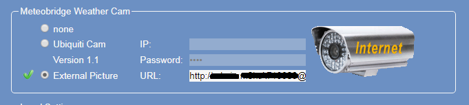

Re: Setting up a webcam
First, you need a URL where your camera provides a still image.
Have you figured out this URL? It varies from CAM to CAM.
Second, insert that URL in the CAM URL field on Meteobridge "Station" tab.
Press "save" and you are fine.
Please keep in mind that your CAM should have a fixed IP in your LAN.
Otherwise Meteobridge will request data from an IP that might no longer
be used by your CAM.
Simply find out with your browser which URL to call to have your camera reporting a jpeg image.
When IP of your cam is 192.168.1.123 then some cams report a still image on URL "http://192.168.1.123/snap.jpg". But this is just an example it depends from the type of camera you have. Use google or read your cams handbook to find out how to grab a still image from your camera. We don't know.
I have a Hikvision and the this is in the camera line on Meteobridge:
http://user:password@10.10.10.200/Strea ... /1/picture
Success!! Thanks for the help.

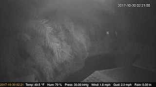

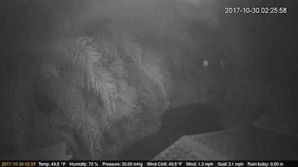

Thanks for providing your login credentials. As the solution might also be interesting for others I post my findings here:
I can login and reach both pix (cam and camplus) with the provided links, but
camplus does not have the expected weather annotation as the input image
has different width/height relation than the standard templates made for
the Ubiquiti cams assume. Resulting image size for your setting is 640x360
instead of the expected 640x480. Therefore the footer is located outside your
converted image boundaries. Below you find the modified conversion string,
which I entered manually.
Result looks now fine to me:
When you select "Imp. EN (Cam 1.2/3.x)" the standard conversion for
that Ubiquiti camera works fine, as they have a width/height relation
comparable to your cam. Result also looks fine:
