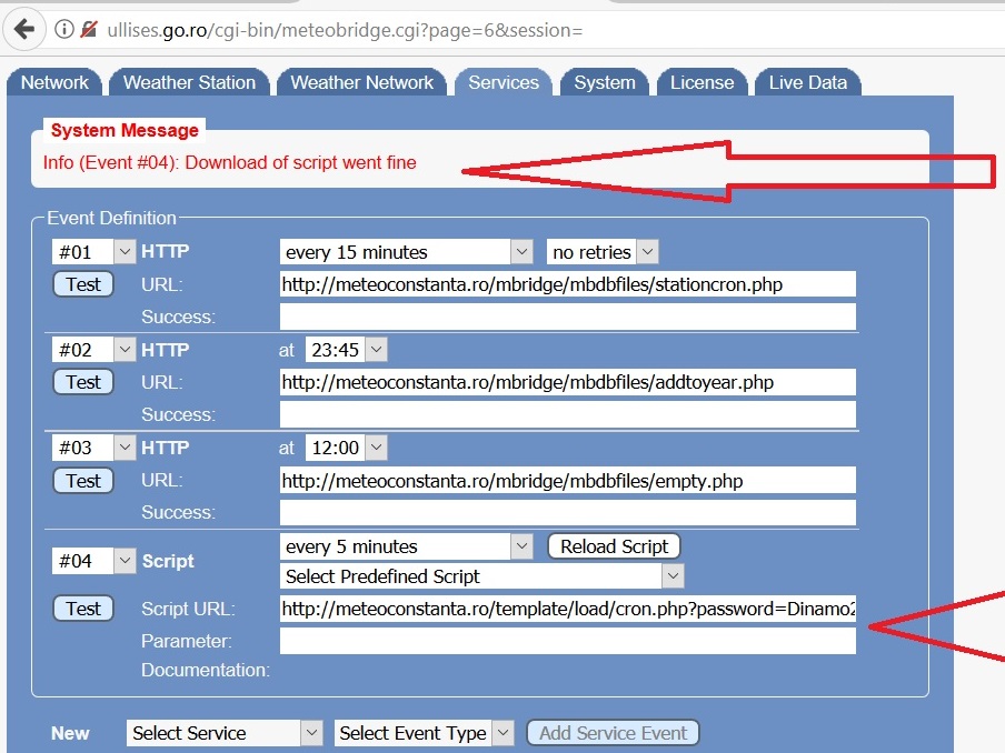

Hi , i cant seem to get it to work -script for uploading images in Meteotemplate ....webcam plugin (timelapse)
Strange is that when i press "reload script" is just fine...
Spoke with Jachym many times , he says is all set ok in the template and everything...
Any help is much apreciated

cant help with meteo thing but you should also change the time of the empty script to midnight 00:00 not 12:00 .

Meteobridge just calls the URL every 5 minutes with data as URL parameters. You can check on "live data" tab if that happens.
If the script on your server is running fine or failing is something outside of the control of Meteobridge. So I would checkout
first if you have a server issue where your script is not working fine or if you have a Meteobridge issue, that your server script is not triggered by Meteobridge every 5 minutes as expected.
