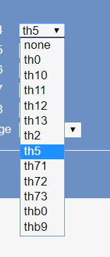

I have two soil stations, Transmitter ID's #4 and #6.
I am using a template to throw the data to a webpage.
With Station 1, I get the temperature and humidity selectors th10temp-th13temp which work fine.
For the second station, for some reason, there is no th70temp selector, but 71, 72 and 73 are available, though 70 clearly's there.
Any idea what's wrong?

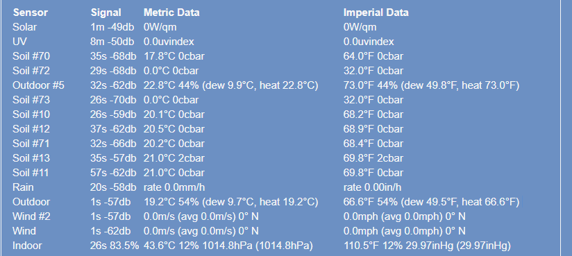

When I get you right you have soil#70 in your live data but not in the historical data?
As I don't have that sensor situation I cannot say from here. If you give me remote
access I can have a look, "info(at)meteobridge.com".

That's correct. #70 is physically there and picked up, but the selector (th70temp) in templates returns nothing, and history doesn't even show th70temp.
I've sent a PM with remote access info.
Re: Missing Sensor **solved**
th70 was wrongly mapped. This is fixed in the just released update.
