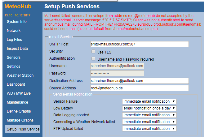

I now tried to use the Push Services / e-Mail Service together with my @outlook.com address insted the previousely used @ gmx.at address.
Unfortunately I do not find the correct settings, so that Meteohub accepts what I have entered.

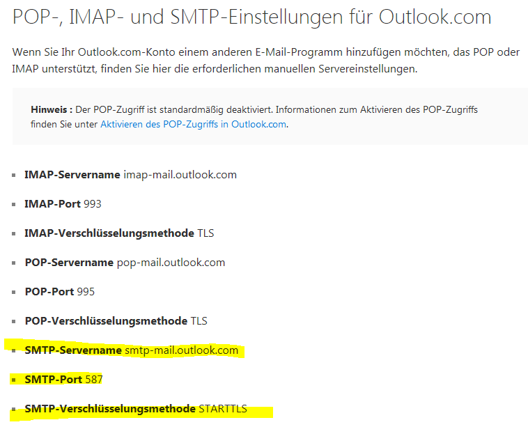

According to the Microsoft Help the settings should be:
- SMTP server name is smtp-mail.outlook.com
- SMTP port 587
- SMTP encryption mode is STARTTLS (Where shall I enter this @ Meteohub)

the settings for SMTP according to Microsoft Help
the settings I entered in Meteohub interface

Try a Source-address in the same domain as the SMTP server

Thanks for the hint, :) ... it works, when I use the same e-mail address for Destination Address as for Source Address. Furthermore I activated the checkbox "use TLS" for security.
