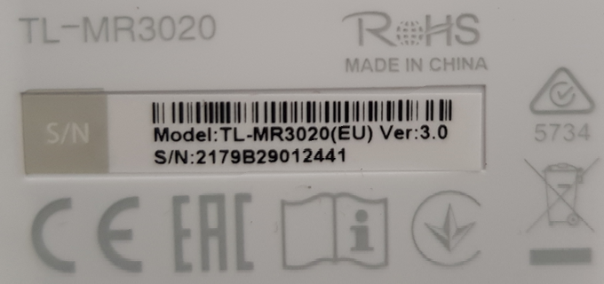

For the time being, please just avoid these V3 models. Model indication is given on the data sticker at the back of the unit.

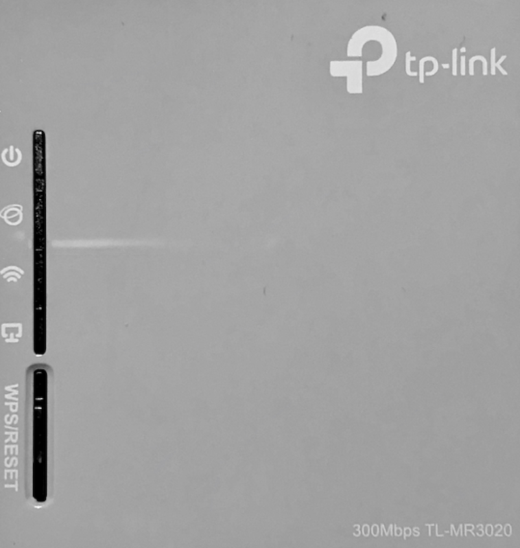

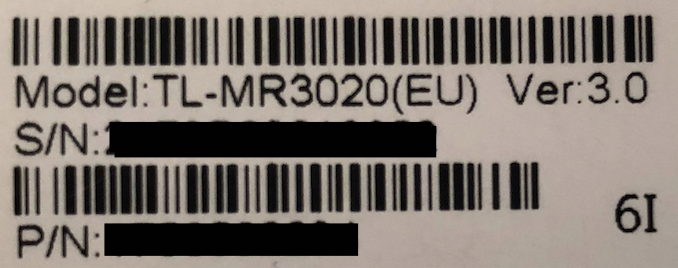

For the time being, please don't buy a version 3 by accident. You can distinguish the new ones by the "Ver:3.0" sticker on the package and the front of the housing shows a slightly different TP-Link logo and has a "300Mbps" text phrase on it. Stay away from those!
Sticker of version 3 models:
Logo and text on front of the housing:
