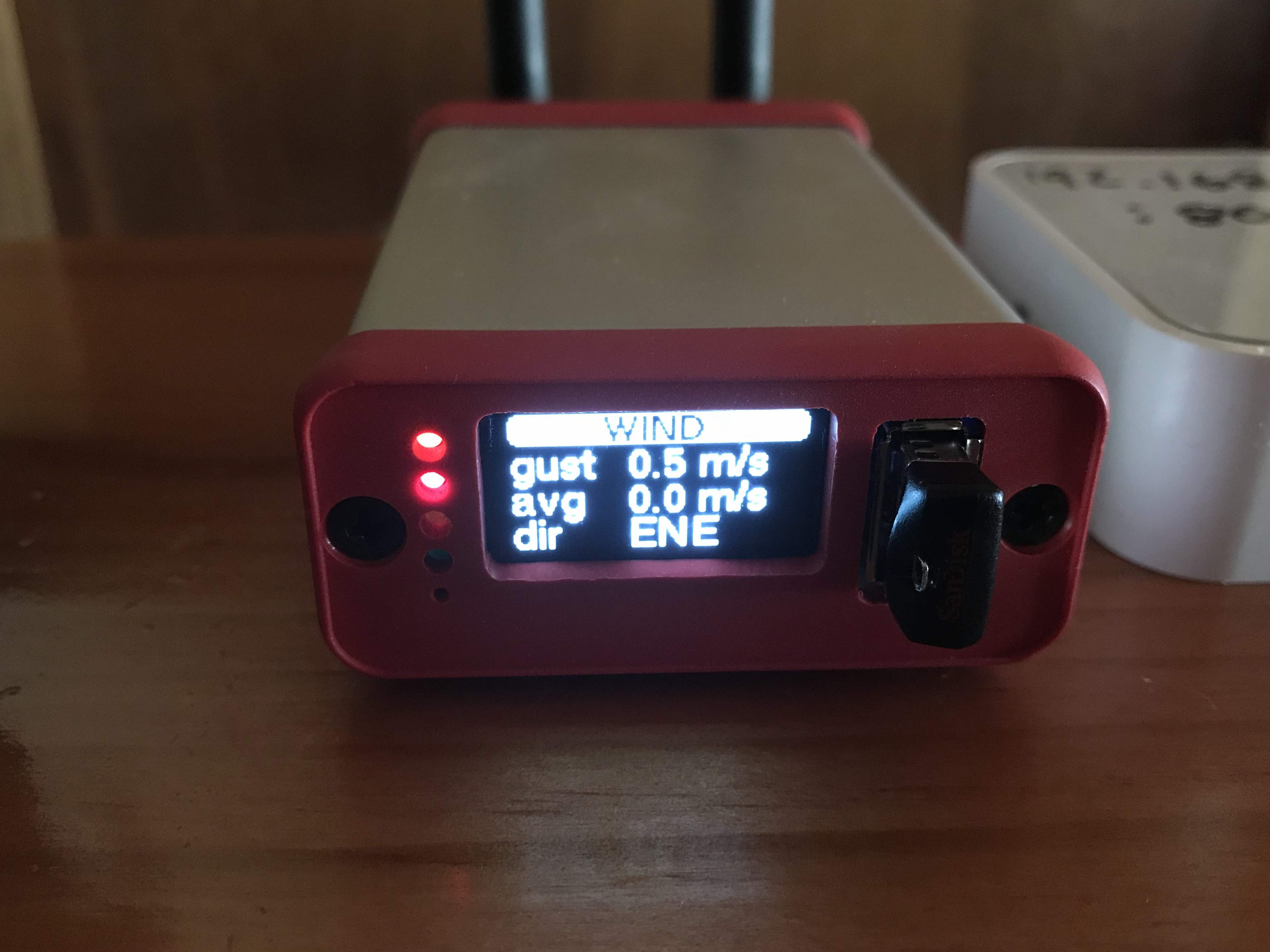

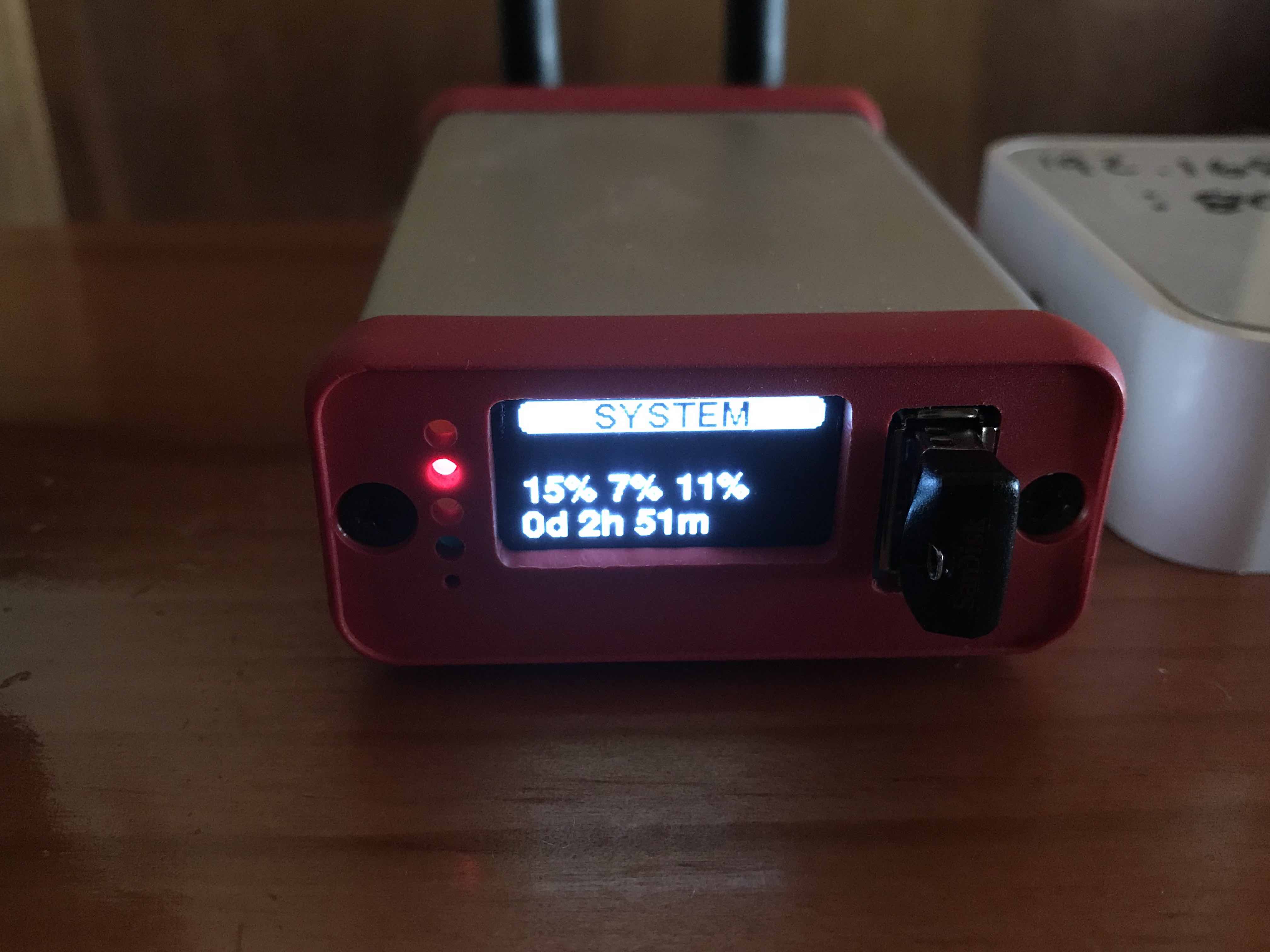

My meteobridge pro seems to be missing some info....see attached photos.
I have rebooted and get the same result..
All else working it is just the "info screen"
Could this be a hardware or a software problem and does anyone know if I can fix this ?
Kind regards,
Leon Rossouw

Re: Pro LCD screen missing some info
Strange, display is physically working as can be seen on your second picture.
Which display template are you using? Knowing that I can have a look at the code.
When I get it right the IP should be displayed, where the gap is. Reason will be that template variable "[mbsystem-ip:--]" delivers an empty string.
Why that I can't say from here. Could you provide me a remote login? If you like, please send credentials to "info(at)smartbedded.com".
That was a software bug introduced by one of the changes around support of new hardware. Sorry for that and thanks for spotting it. I just released an update which fixes this.
