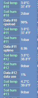

I've just recently setup a Meteobridge Pro (Red) with my Davis Vantage Pro 2 weather station. I'm loving the graphing features and the additional tags and selectors. Everytings seems to be working fine except the data for the soil station which appears to be getting separate figures for the temperature and mositure:
As an example heres the current data from the Meteobridge Pro.
Which gives the following:
Soil Temp1 3.0°C
Soil Temp2 3.0°C
Soil Temp3 3.8°C
Soil Temp4 4.2°C
Soil Moisture1 2cb
Soil Moisture2 1cb
Soil Moisture3 0cb
Soil Moisture4 0cb

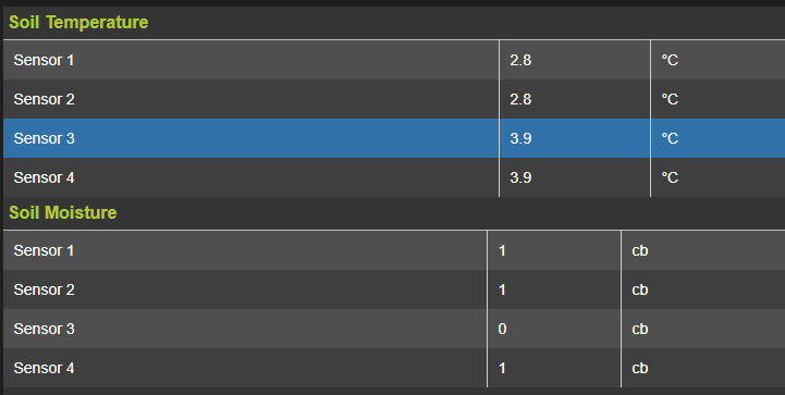

And heres the same data in CumulusMX
Both Weatherlink and CumulusMX give the sensor data as follows:
Soil Temp1 2.8°C
Soil Temp2 2.8°C
Soil Temp3 3.9°C
Soil Temp4 3.9°C
Soil Moisture1 1cb
Soil Moisture2 1cb
Soil Moisture3 0cb
Soil Moisture4 1cb
As you can see the Weatherlink Data matches the Cumulus Data which also appears to match the Vantage Pro Console (Temperatures are reported as whole numbers in the console).

Re: Meteobridge Pro Red - Soil Station Data Differences with Weatherlink and Cumulus
Is MB PRO reading RF data from the sensors while Weatherlink and Cumulus are using the Davis logger?
If so, minor differences are to be expected as the sensors are not sending this data as digital values but
as raw data that needs to be approximated to proper temps. We tried to convert as close to the Davis
interpretation as we can, but it is of course not 100% identical.
Regards,
Boris
