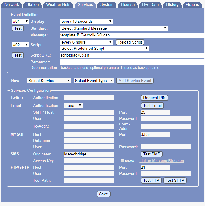

I am trying to set up a backup script and it is doing my head in.
I haqve inserted a formatted fat32 usb in the front of the meteobridge. I have set up the script and it keeps telling me no media found.
Please see the attachments. I don't know where it is going wrong.
This thing can be the most frustrating piece of equipment!
Meteobridge System.png (142.9 KiB) Viewed 3313 times
Meteobridge Services.png (57.59 KiB) Viewed 3313 times

Looks like the target USB stick is not partitioned the right way. Does it have one partition and this one formatted as FAT32?

I have tried two different USB sticks both formatted FAT32
Re: Trying to Set Up Backup Script No Target Media Found
Could you give me a remote login with the backup stick attached? Please send credentials to "info(at)meteobridge.com".

Problem is solved. For some reason the bridge did not like the usb formatted in win 10. Using diskpart and cleaning the stick and re-formatting worked.
Thank you to admin for the help.
