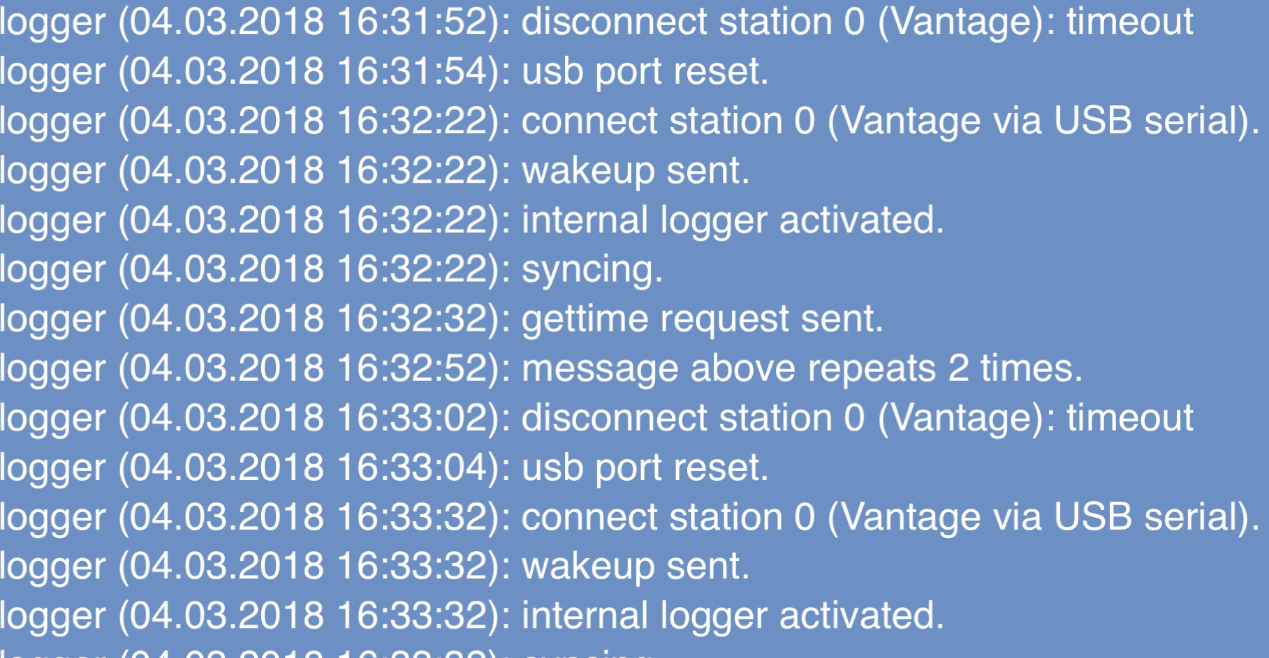

Hi, I am not getting any data from Vantage Pro2 to TP-Link MR3020 with Meteobridge. MB connected Ethernet to router. No WiFi in this setup. The VantagePro is serial-to-USB 2.0 hub then to the MB. There’s no live data when I’m logged in to the MB. Any ideas? Please help. I’ve been at this for months.

I’ve tried that a couple times. Maybe I’m getting re-connect order wrong? On MB, I have weather station set to USB. And in Network tab on MB it’s set to LAN. Wireless LAN didn’t seem to work either.

On the Weather Stations tab at bottom for Local Settings, Serial USB switch is set to none. Would that have to be changed since my Davis logger is a serial connection that’s plugged into a USB 2.0 converter?
Pulling logger, batteries and power from console did not work unfortunately.
Also, when my Davis console reboots, it says Station 1. Yet the meteobridge says trying to reconnect Station 0. If that matters.

Please don't touch network tab as doing things wrong there will cut off your Meteobridge from your LAN/WLAN. The messages don't tell me that the USB connection is dropping, which is typical if the USB hub is missing or a "wrong" one.

Yes, I have followed each step that you laid out here. The network setting is the same: type of connection is LAN since Ethernet is connected direct. Still doesn’t work. When I was using my PC, I just plugged the serial connector from the logger into the PC and had no issues. But when I plug the serial logger into the usb hub, the meteobridge just doesn’t seem to read anything. Is there any other info I can provide that might help solve?
