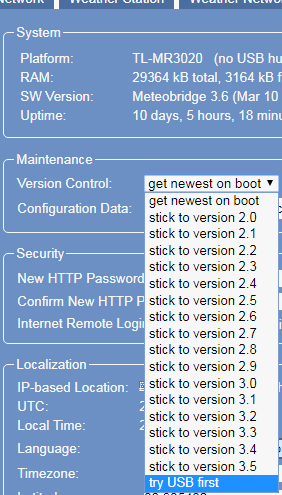

Do you have "try USB first" as a option?
meteobridge 026.png (23.45 KiB) Viewed 5988 times

I have USB-stick connected. Dont have "use installed version" but "Try usb first", guess that must be the one to use.
