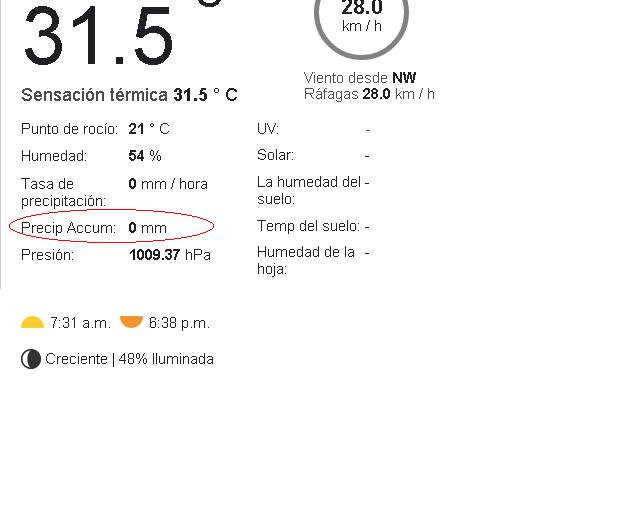

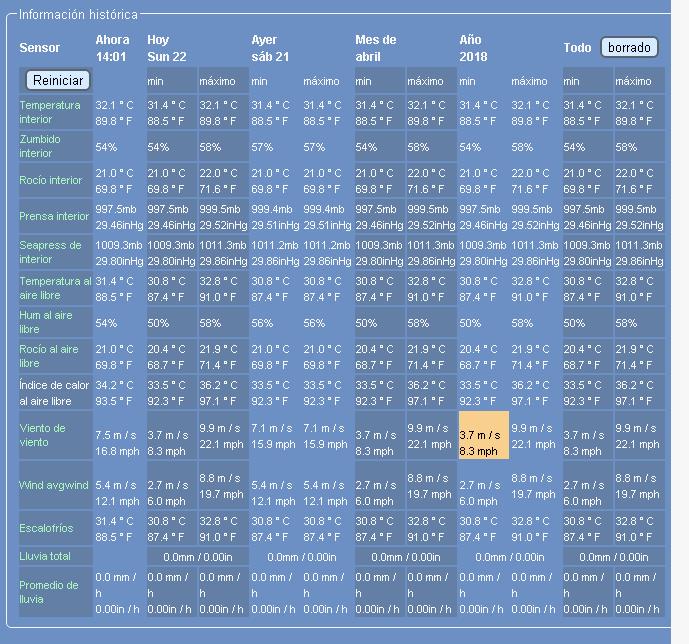

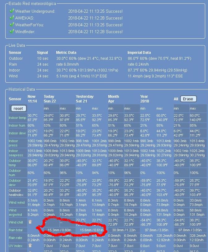

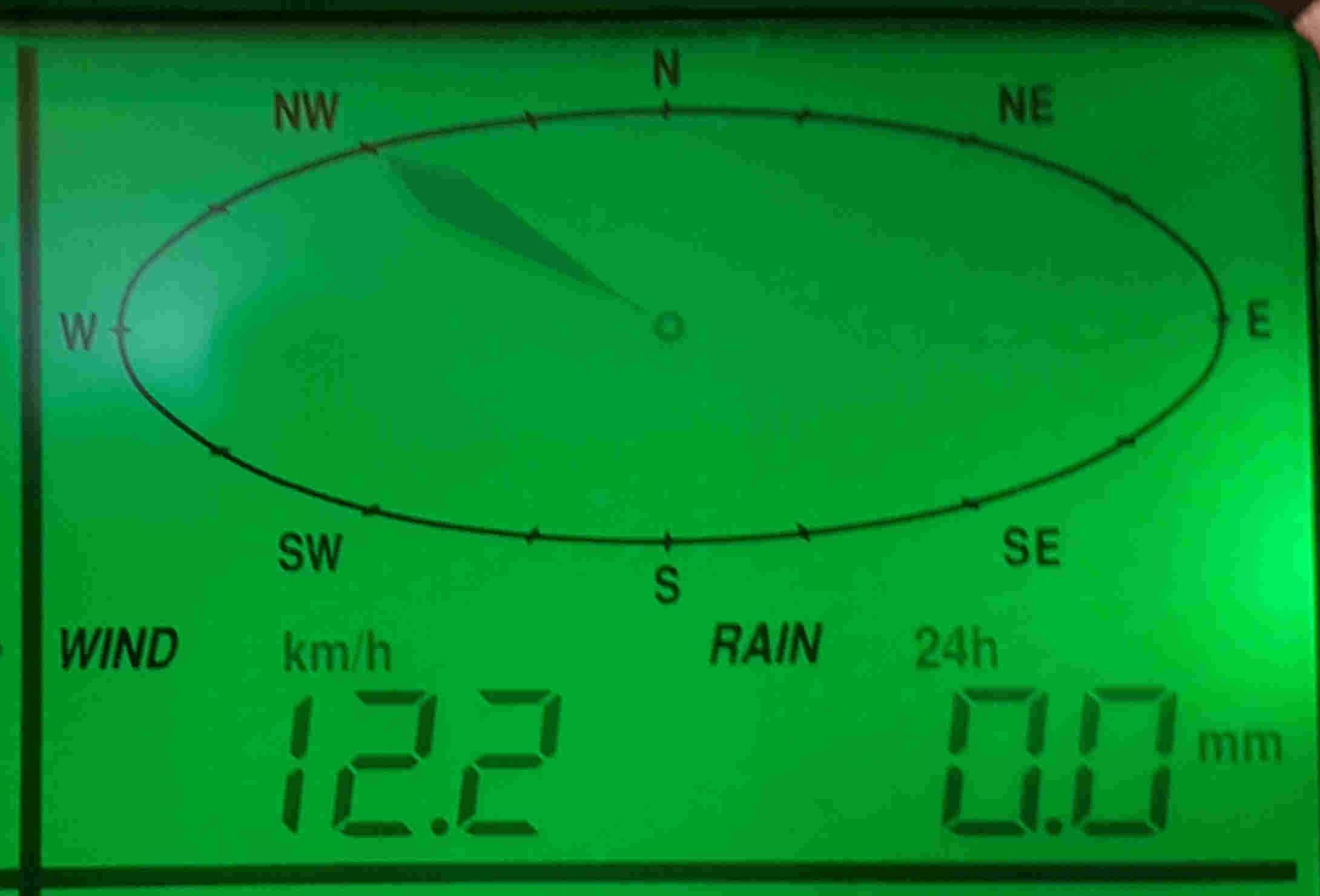

I have problems meteobrige reports false rains throughout the day.
These are not listed in the console as shown in the image. My setup wh1080 + tl-mr3020 + meteobridge 3.6.
This problem did not have it with the previous wh3080.
Solution?
Excuse me, my English is a Google translation

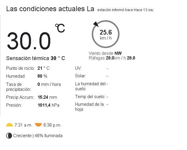

I see that WU does not show more accumulated presipitation,
I deleted all the meteobridge historical data.
Could the data be mixed because they are different models?
