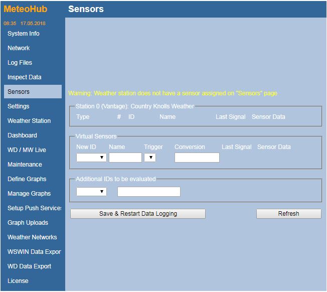

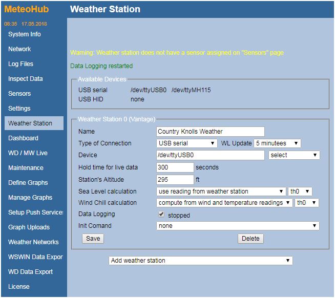

So I think I got everything right on the install, but for whatever reason I can't get the thing to pull any data. Using a Weatherlink USB data logger C series and a Vantage Vue. It sees it, works fine on my other install on CumulusMX, but I can't get it working here at all. Thoughts?
logger (17.05.2018 08:12:30): data logger (version 5.0x, build 200) started.
logger (17.05.2018 08:12:30): connect station 0 (Vantage via USB serial).

Please unmark "data logging stopped" on Weather Station page.

I can't believe I missed this! Thanks for the help. Working on configuring the station now. I was worried my logger was too old.
