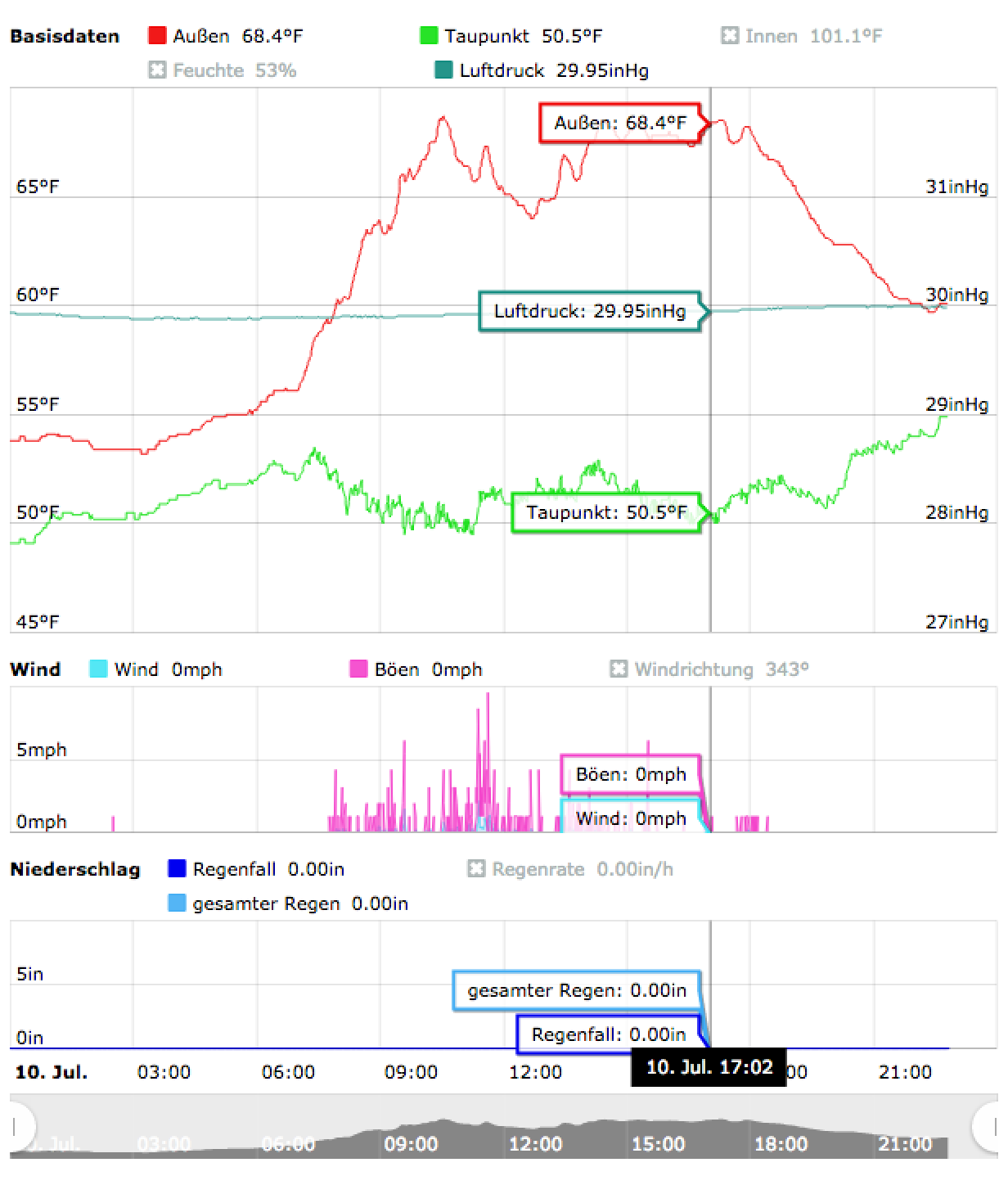

Re: Chart language
I tested with my rig and selecting a language works fine, I tried with German.
Screen Shot 2018-07-11 at 00.45.51.png (197.08 KiB) Viewed 7911 times

Re: Chart language
Currently there are no chart specific texts apart from Germany and English defined. The language selector just triggers the naming of months in the selected language (if not EN or DE). But you can help me to make the charts fully appear in your language of choice by replacing the expressions behind the colon in the definition outlined below. I can then add this to the next release.
