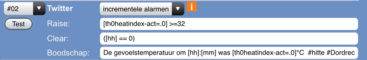

Can you please help me with this Twitter alarm; this way (see attached picture) it will only send out a alarm when temp reached 32°C But I want also send out a alarm when temp increases to 33, 34 etc that same day. What I’m doing wrong? Thanks for helping out

Hm, definition looks ok… can you please change to "[th0heatindex-act.0:0] - 31" and check the "i" icon on raised alerts.

I have now changed it in " - 31" and the "i" icon shows other values now; First it said "raised condition #2: 20>=32->false (0.0000)"
After I changed it as you mentioned, it says: "raised condition #2: 20 - 31 -> false (-11.0000)"
Is that the right way for the system to interpret what I'm asking
Isn't right to use the < or > or = when using " incremental alarm" ? Because if so, I have to change another alarm I've made for wind with windspeed < 75 km.
Hope hearing from you again.

It should work both ways. Values greater zero are regarded true, else false. Advantage with the new formula is that one can more easily see in the log if the computation was done correctly.
