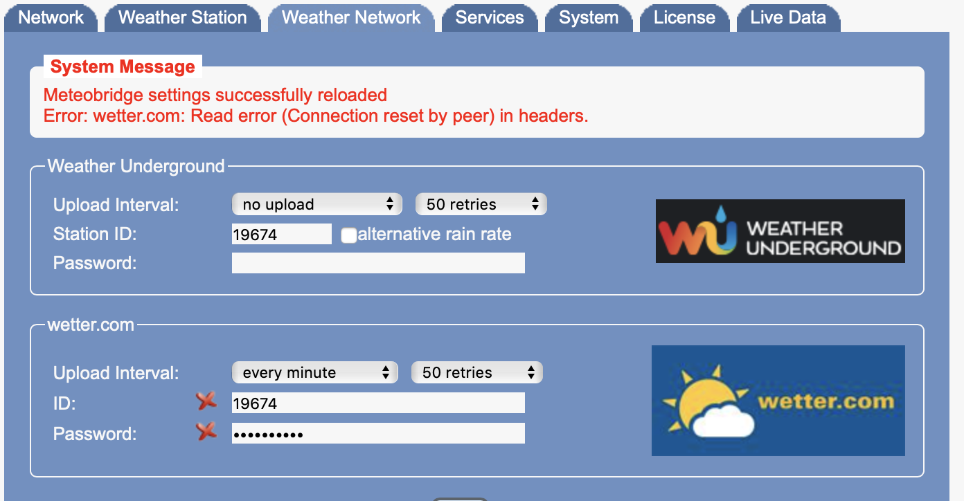

Not sure whether this is related, but since a couple of days my NANO can no longert post weather data to wetter.com, please see attached screenshot.
-->Meteobridge 3.7 (Sep 28 2018, build 1156), FW 1.0
Bildschirmfoto 2018-09-30 um 13.25.01.png (224.35 KiB) Viewed 7079 times
Re: HTTP stopped working
There seems to be an issue at the wetter.com uploads. I had reports from other users as well. However, should be nothing special related to the NANO.

Thanks for your reply, looks like you are right. I sniffed the network traffic with the wetter.com upload server and it seems that it disconnects the session immediately after getting the http get request from the NANO. I sent them a mail, but no response yet.
Cheers, -pl
