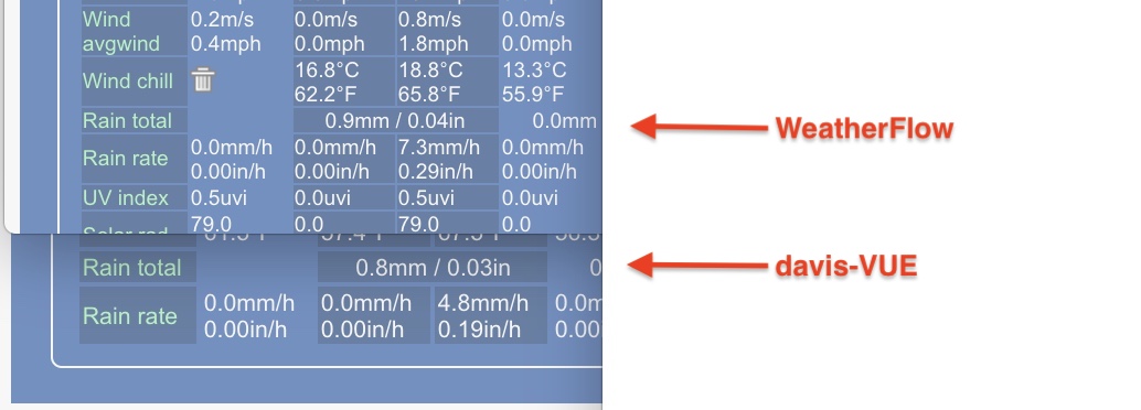

Re: Rain total different from Weatherflow. **solved**
I had to wait until it would rain (or drizzle) but all OK here also. As it was night-time I did not catch the UDP packets, but there will be ample rain next week. For now the values between the VUE and the WF are comparable. i assume that for a longer period of rain the values will be even closer.
