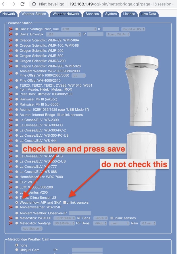

I have the same question. I just received a used Meteobridge PRO and it isn't seeing any of my WeatherFlow station data. I did add the WeatherFlow network and my WF login credentials but no luck.
Any suggestions?

Good morning,
You are posting this question on a Meteohub discussion. But you have a Meteobridge Same forum, different topics. Just can take more time before someone answers.
As from release 3.4 released February 24, 2018 (check https://www.meteobridge.com/wiki/index.php/Forum ) the WeatherFlow is fully supported.
  • You should not set "the WeatherFlow network and my WF login credentials" that is for uploading to the WF network and that is done by the WF itself.
  • You should select the Weatherflow at the Weatherstation tab as in the attached screenshot.
Important: The Weatherflow AND your Meteobridge(Pro) should be on the same LAN network.
The station data is gathered from your (wireless) LAN by reading the UDP packets your WF transmits to anybody listening. And UDP can not be routed. So check your IP addresses that they are in the same range.
