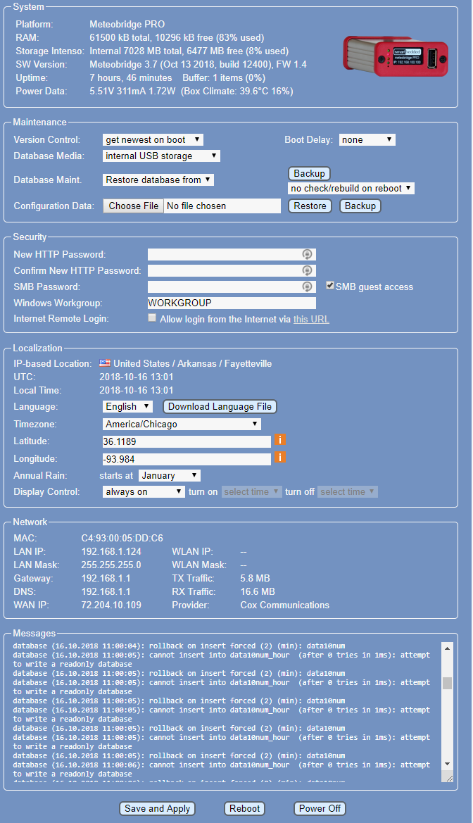

Screenshot 2018-10-16 08.02.07crop.png (101.54 KiB) Viewed 1292 times
My Weatherbridge pro has always been a very reliable device but recently have been getting some offline error messages. In particular from Weathercloud. I can't say if the offline status is specific to this one service or just the first to inform of a problem.
Usually a quick power cycle and all is good to go again but lately, that doesn't seem to work too well.
This next section is going to be lacking on specifics because I just assumed any problems were probably related to my network and not the MB Pro.
The unit appears to hang on with the next to top red light fast blinking and no access via the web interface.
I tried rebooting and resetting the unit and a few times it previously would connect. This last time, I either was too impatient or the unit is having a problem which I couldn't recognize. In my attempt to restart the unit I finally did a factory reset and moved to a wired connect instead of wifi.
After a many many minutes of the fast blinking, the pre-web warning page appeared and I could see traffic from and to the internet but it took much longer for the web interface to appear. The log showed this this morning after 8 hours
I rebooted the unit after this screen cap and the log showed this message:
oled (16.10.2018 13:01:33): process started.
test5m (16.10.2018 13:46:12): weathernet daemon stalled, will be restarted now.
test5m (16.10.2018 13:46:13): logger stalled, will be restarted now.
system (16.10.2018 13:46:13): stop of logging process initiated.
wnetd (16.10.2018 13:46:13): process started.
test5m (16.10.2018 13:50:03): logger stalled, will be restarted now.
Although the screen has severe burn in issues, the unit right now is not connected to wired connection, does not appear to be connected to wifi and has a solid red light next to the top (second). The screen has 2 vertical white lines.
Suggestions on where to start.

Looks like a USB storage failure to me. Can you please send remote login credentials to me "info(at)smartbedded.com" so that I can check for details?
